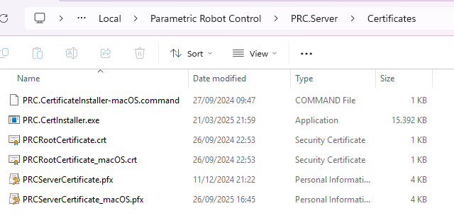

Enter the following address in the Windows Explorer:
%localAppdata%\Parametric Robot Control\PRC.Server\Certificates
That will get you here:

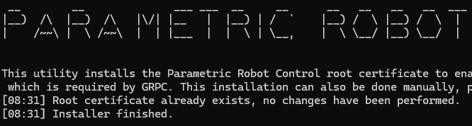

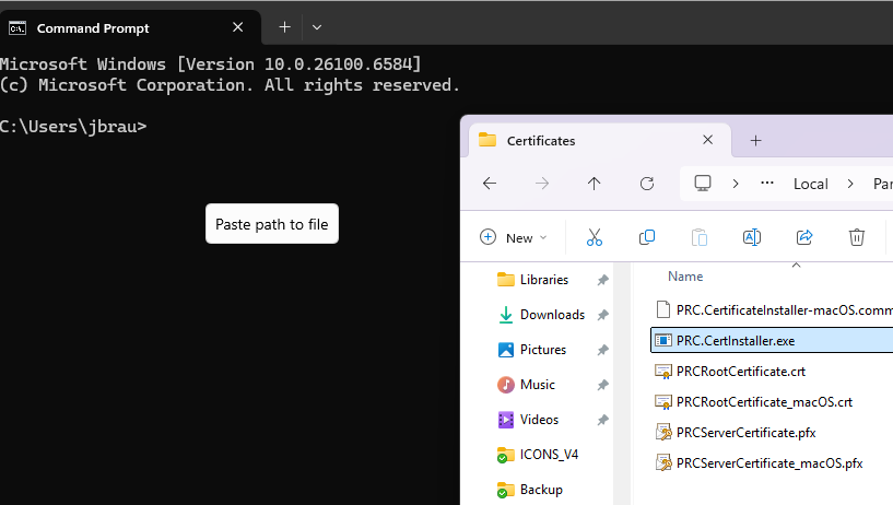

Running the PRC.CertInstaller.exe only briefly blinks up, however you can open a Command Prompt window and run it there, e.g. by dragging the file into that window:
If everything is as intended it returns that no changes had to be performed:

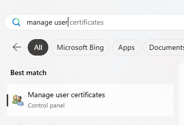

Next, please check the certificates. Run “Manage User Certificates” from the start menu.

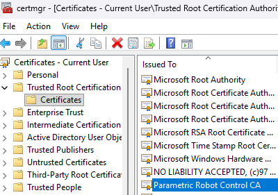

And check if it contains the following certificate:
Software such as antivirus programs may block the installation of new certificates. If the certificate is missing, try following the manual installation steps for Windows laid out here.
