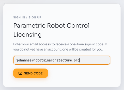

You are now forwarded to the PRC License Server, hosted on Azure. Click "Sign in" to proceed.
You will have to enter your email address to proceed. If this is your first time signing up, the system will ask you for your name and affiliation. You will then be sent a one-time password consisting of 6 digits. Enter it.
Then click “Request Activation”. You will then be informed about the license that has been assigned to you. Contact johannes@robotsinarchitecture.org if there are any issues. Click the button to go back to the PRC Settings.
